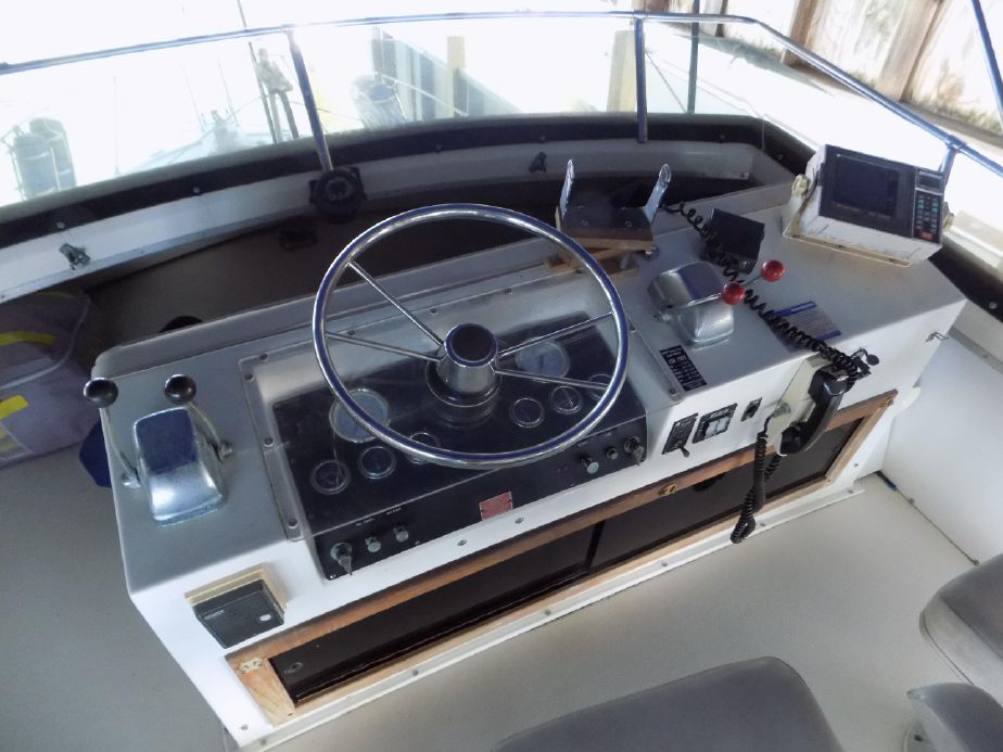

We don't like the console used on our 70's model F32 upper helm. Its low, has a silly backwards seat on the starboard side and has no place to mount electronics, etc.
We would like to upgrade :wink: to the 80's style console (photo from 198x Dan Faith's F32: http://s251.photobucket.com/user/DANFAI ... E.jpg.html). We have to replace the floor on the flybridge and want to upgrade, but retain the chain drive (I've rebuilt it all, and it works fine).

Ross this is a 78 F32 helm I found on Yacht world you could redo yours to be like this . I know someone that did it on a clean machine f30
1978 F32
1978 F32
F32 helm 78.jpg (85.48 KiB) Viewed 17242 times

Yes, that 78 is my helm with the built-in aft facing seat removed.
I really want something where I can mount electronics, etc. like the 80's upper helm consoles.
I'll have to add a U-Joint to the steering shaft...

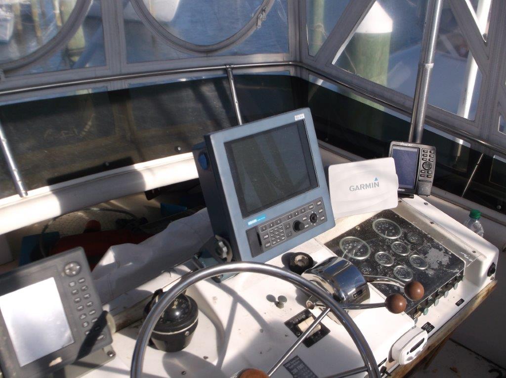

Finally able to post a photo..
Here is Dan Faith's F32 upper helm:
Re: F32/F36 Upper Station Console
That's like the newer F36 ones
