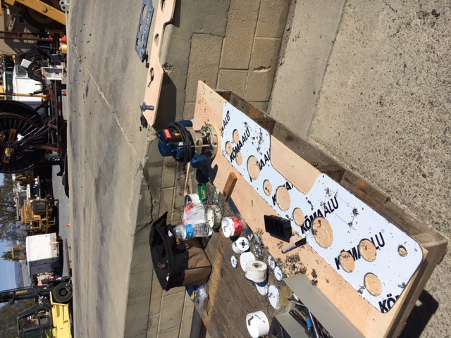

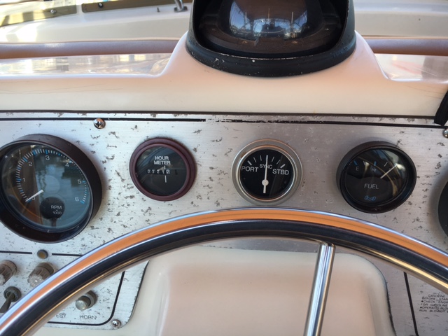

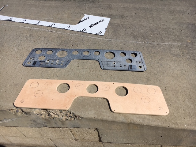

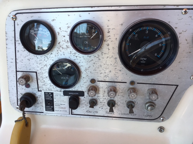

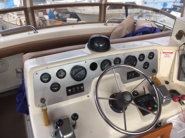

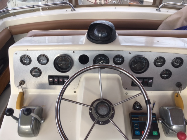

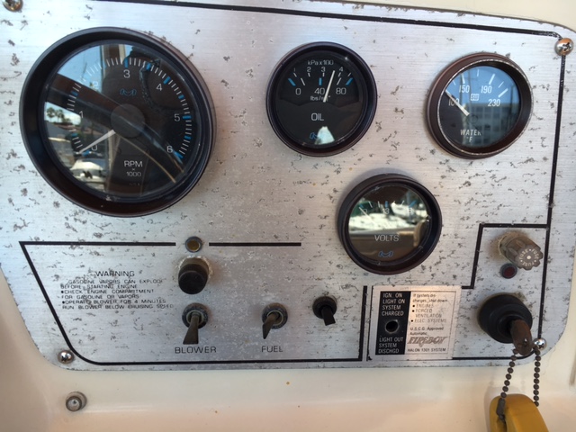

I just completed the replacement of the helm instrument panel on our boat, time and previous owners had taken its toll on the original panel, switches and gauges were mismatched and erratic , the ignition switches were old tired and the panel itself was faded and corroded. I replaced the panel with a product called KOMALU , which is a laminated plastic with a thin decorative cover of brushed metal on one sited and white on the other and rated for harsh environments, and inexpensive too boot. http://www.kommerlingusa.com/pvc-manufa ... ut-us.cfml
I installed Datcon industrial gauges and replaced the oil pressure & water temp sending units , I installed the Flowscan system I had bought for our old but never installed, I went with the twin engine single gauge set up to try and keep the panel clean and uncluttered. I also installed a new breaker panel under the console and rewired all of the components on the bridge, gauges, switches lighting and electronics, including running 4 gauge battery cable from the batteries to the bridge,
I think I removed 20 pounds of unused wiring from previous installations... what a mess!
