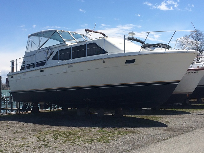

After soda blasting and base coating the bottom of our 1979 36 Tri, we put on Interlux ACT ablative dark blue bottom paint. It went on near black and after contact with the water it changed to medium blue above the water line (close to Trojan Blue). As the season went on it got lighter and chalkier. The next year we tried black with it turning to light grey. Is there an ablative paint that holds the color better or is that the nature of the beast.

All bottom paints will get dull to some degree . I have had very good luck with west marine PCA Gold ablative in Blue . They Had some issues with the black going on with a slight brownish tint but it was hard to tell in the water and they said its been resolved . My blue still looks good and the black on the boat behind me also looks good . No issues with growth also . I am in year round lower part of Va

+1 on the blue West Marine PCA Gold. I believe it is a private label of Petit Ultima SR-40.
We are going on one year in the water with ours and planning on staying in for two years before pulling the boat and putting on another coat. The previous owner of our boat was going three years with annual haul out and minor touchup of the bottom paint.
So far, the PCA Gold seems to be holding color better than whatever the previous owner was using, though it does get a shade lighter once it has been wet.

I use Woolsey with great results. In year-round, but practically fresh water.
Welcome to the forum! Great looking boat, if I may say. What year? Pre '81 I think... One of my current projects is upgrading my bow pulpit. Let me know if you are interested in a good deal on a slightly used but perfect fit bow pulpit. Comes complete with partly removed varnish!

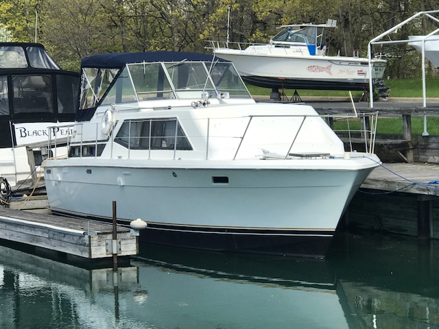

Thanks for the advice on the PCA Gold paint, it's holding the color much better than the ACT. The new top helps also
