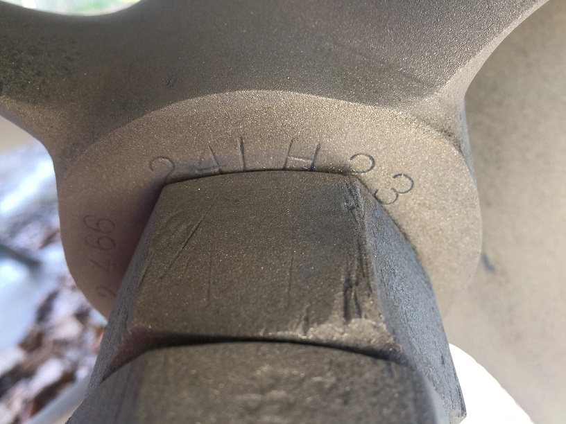

Not exactly the same boat, but I have the 1990 12M Express with 671-TAs. 2550 Max RPM and I have 24x23 4 blade props on mine.
