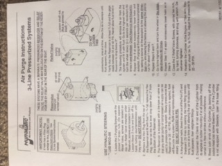

Here is the link the the owners manual for the Hynautic.
https://www.trojanboats.net/zencart/ind ... 6cfcf6c64d
Or see photo of air purge instructions.
- IMG_7163.JPG (41.72 KiB) Viewed 11695 times

Works the same way on single station ( 9 Meter )
Follow instructions on on single sheet in post above or down load the manual.
Add fluid
Purge system
Check fluid
Add air pressure
Test
We recommend you keep a bike pump on board if
you ever need to do this when away from home port.
Add fluid
Purge system
Check fluid
Add air pressure
Test
