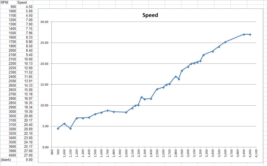

Here is a speed curve based on averages of speeds observed at various RPMs over 17 (wow) years. One of these days maybe I will add markers for high and low speed seen for each RPM... Speeds are in knots as reported by my GPS.
The 'sweet spot' for displacement cruise is about 1500 RPM (8 knots or so), and fast cruise is around 3000-3200 RPM range - just before the secondary barrels open on the carbs and start guzzling that much more fuel for little speed gain.
