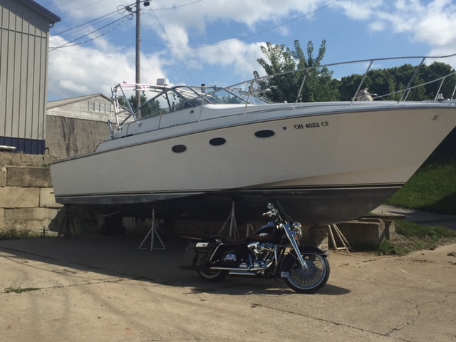

I recently acquired a beautiful 1983 Trojan 10 meter International. The old mercursier 454's are tired and I'm seriously considering investing a 'boat load' of money into repowering with diesel engines.
I'm looking for new ( or used) Yanmar 4YB180's (pair).
I've been told the new Yanmar's are electronic and although super fuel efficient, they are super expensive (like $32K/ each).
Any leads on the 180's or any suggestions would be much appreciated.

Thanks for the reply prowlersfish,
I have the 10 meter express (1983)
The Fiberglass arch has been removed and a stainless steel arch replaced.
It's an awesome looking boat.
How do you load pics on here?
When I try to attach a photo file I get a 'file too large' response.

The '83 express is not the mid cabin boat.
It features the engine room liner and the stringers with no structural wood.
I REPOWERED MY 1983 SAME BOAT AS YOURS WITH TWIN YANMAR 6LP turbodiesels.
Completely changed the character of the boat and there are many posts on this FORUM REGARDING THE MANY BENEFITS OF CHANGING OUT TO THE DIESELS.
