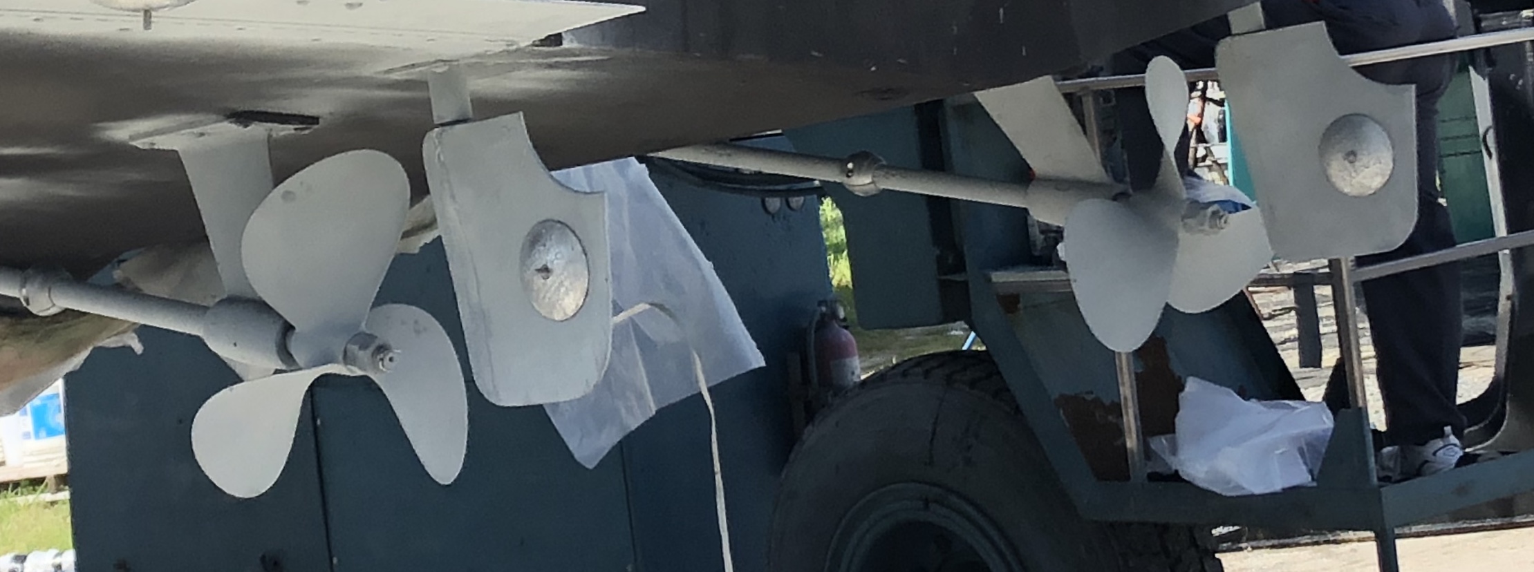

My 1980 Trojan F32 with twin Chrysler M360 is not reaching anywhere near top end. The maximum RPMs I have been able to achieve is 3,190 on both engines. Max speed was 20.2 knots with about 200 gallons of fuel onboard and no water. Just painted the bottom and all running gear is in good shape.

Did you happen to see the size on your props ? Both engines sound the same ?

Unfortunately, I didn’t get a chance to pull off the props before I launched it back into the water last week. I will check this weekend to see if my paperwork shows anything.

The speed is about right for those RPMs (at least what I get with my 16x16 cupped props), so probably not a case of drag and you likely have the right props if you match the normal speed curve.
Start with the easy stuff first... Are throttle detents or cable length keeping you from pushing to true full wide open? Are distributors properly advancing as RPMs climb? Do the engines sound or feel bogged down or do they seem to be running well? Any plugged tank vents?
Re: Not able to reach top end on F32
Would be good to know the prop size . Check you tachs ( I have a photo tach you can use) . make sure the 4 barrels are opening and the carb linkage for full travel . try using the trim tabs too. Knocking off some pitch can help get the engine up in its power band and get more rpm and speed at wot .
