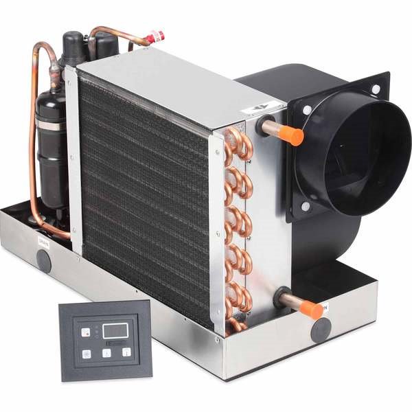

They are all over in fact most off the marine AC you find on line now are stand alone . By stand alone meaning the compressor /evaporator /condenser is all in one unit . Self contained is what some call them . of course you need to hook up vent hoses and a water pump . This is not something you can easly run of a invertor . Yes it can be done with a very large battery bank and inverter costs would be up near a good marine genset by the time you get done and time limited , as you need to recharge the batteries .
https://www.westmarine.com/air-conditioners
