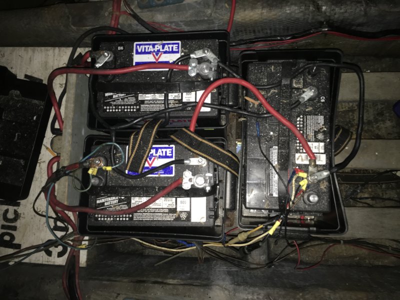

Hi Everyone, I'm a proud new owner of a 1976 Trojan f-32 Sedan. I'm already a trojan fan for life.. lol
But I'm trying to get familiar with my new boat. And I've read everything I can about the battery set up and I'm stumped. I just want to be sure my batteries are hooked up right. I've used the boat briefly three times with no issues. And I was hooked to shore power in between. I know there is a charger onboard but I failed to get a picture of it. Can someone look at this battery set up and tell me if its right?I see positive cables all hooked together and I seems like the batteries aren't isolated like they are supposed to be. And yes I plan on cleaning up al the connections and tidying up the wire runs before next summer. Thanks in advance attachment=0]IMG_4641.JPG[/attachment]

Do you have two 12v battery switches on the panel ? What you should do to help yourself would be to use the right coloured cables for everything, that way visually it is easy the follow and avoids mistakes. Grounds are always black, red is positive. You need protective caps on the positives to stop accidental shorts.
Assuming you have the 2 switches then your bigger battery there should only be connected to one of those others whichever you decide as the house side. You will still have the other two as starboard start and port start with the paralleling switch they can be put together.One of those sides will be start and house.
There are much better ways of building battery banks but that will work for now after you clean things up, its a start....Mike

Thanks Mike, I hear you as far as wire color. This is how I purchased it and cleaning things up means putting everything back to the way it was meant to be...

All 3 are hooked together . Rewiring is in order for sure

I agree with rewiring. I just wish there was some kind of diagram for a twin engine, three battery set up. Trojan didn't do that from the factory as far as I can tell. But correct me if I'm wrong and point me in the right direction for a diagram. I have four or five Electrical Diagrams in my original owners manual. But it doesn't show the battery set up.

Give Beacon a call the site sponsor, they have all the knowledge and paperwork. The problem is that over the years people change things, stuff wears out so hard to find factory original, It looks to me like you are missing the box that held the paralleling solenoid and some aux breakers, although that might be the solenoid just barely visible there.Basically like I said you have a start for the port and a start for the stbd then you can tag on the extra battery to what ever side you choose, just not both.I used the same setup for years and worked fine, mine was on the port side, but on my boat there were the 2 original 12volt on /off switches for the engines etc.BradZ wrote: ↑Thu Nov 01, 2018 12:02 pm I agree with rewiring. I just wish there was some kind of diagram for a twin engine, three battery set up. Trojan didn't do that from the factory as far as I can tell. But correct me if I'm wrong and point me in the right direction for a diagram. I have four or five Electrical Diagrams in my original owners manual. But it doesn't show the battery set up.
