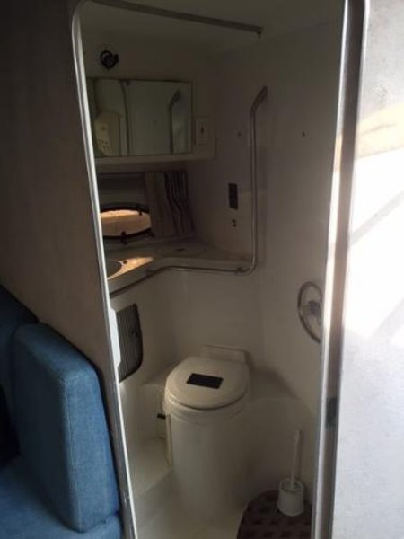

On the 10 meter express is it possible to replace it with a standard marine toilet system? Has anyone done that. If so would appreciate information. Thanks
Re: Vacu-flush system replacement??
Is your head built in ? If not it would be easy , if it is it would take some work to say the least .

I think this would be considered built in. Right?
Yes

With the vacu flush was some water pumped into the toilet basin, as the vacu flush was turned on. If so maybe vacu-flush could be bypassed and the drain hose go directly into the holding tank. Toilet is higher than holding tank. Assume pump out hose comes out of the holding tank so could still have it pumped out. Does the macerator pump pull directly from the holding tank? If so could still pump overboard when permitted, assuming that combination would work. It is my understanding the macerator and the vacu-system are on separate lines. Thanks

As for ditching the vacuflush and going with gravity......note that the exit of my vacuflush toilet has an orifice that is maybe an inch in diameter. If yours is the same, consider what things gravity will get down through that opening.
The heads were the worst thing about my boat when i purchased it. Sealand with integrated holding tank, which meant when solids went down, they displaced vapors upwards. Head use is odor free now. Well, mostly....
