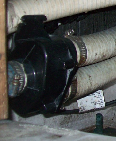

This is in the system connecting to the holding tank. Suspect it is a Y valve with out the handle. One hose comes up from the holding tank and than connects thru this device to two hoses. One goes up for pump out and the other goes to the hull for going overboard. There is a 3/8 inch diameter metal stem coming out of the device with a flat spot on one side, probably for a handle. I put vice grip pliers on it and tried to move it but no luck. Before I go further would like to confirm it is a y valve. If so assume one setting permits pump out at the dock and the other setting permits dump at sea.
I tried running the macerator-have to hold the switch on, spring loaded off. Could hear it run, but nothing came out the hull at that hose location, so either valve set for pump out at the dock, the holding tank is empty, or is there a neutral position for neither condition to be set? Just now though about that.??? Thanks

Looks like it could be a y valve . have you tried taking the boat to a pump out and see what happens ?

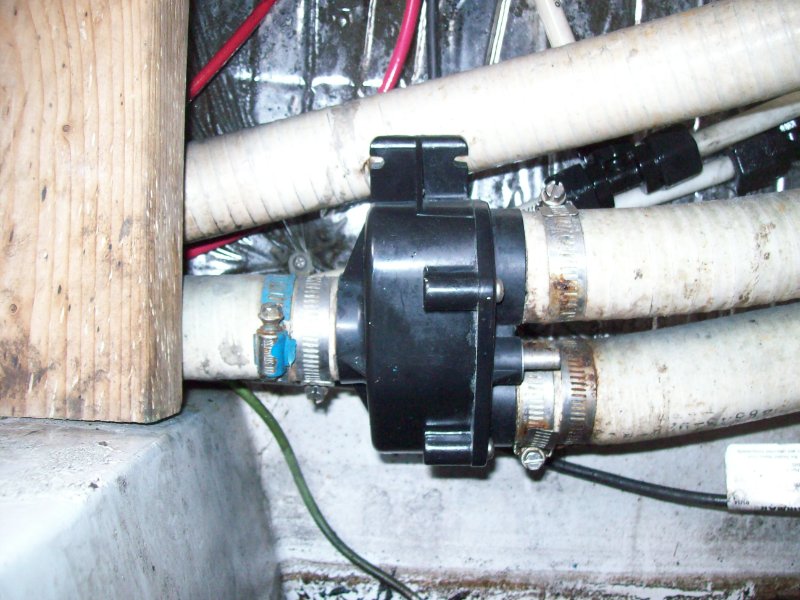

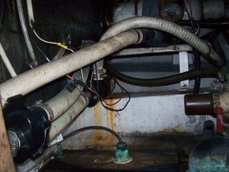

Here is another picture showing the valve stem which is flat on one side. Another picture that shows the plumbing further on. I think I see a macerator pump on the bottom outgoing hose. The other hose goes up to the pump out station. Am I correct?

Thanks for the ID. I will go ahead and attempt to move to one side or the other. From the web link picture suspect the flat spot if parallel with the bottom of the valve. Will look at that and see if I can get an idea of which way it would move to be in the alternate position.
