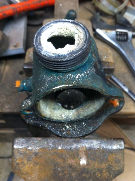

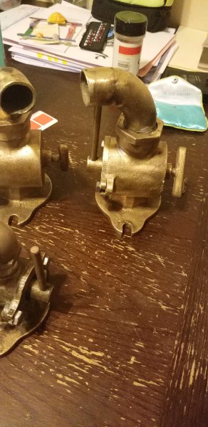

So i sent all 4 of my groco fittings to Bob. They were absolutely disgusting. All locked up. A definite hazard.
Here are before and after pictures of their amazing work.
Definity everyone should check to make sure all of their shut off valves are working properly.

Nice job, I like that those valves can be rebuilt and put into proper use again.

October before last, Bob had a rebuilt set which he sent me and I sent him mine which I removed. Turned out great and now I can get many more years out of them.
