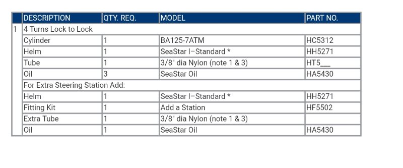

Seastar part numbers:
Helm pumps HH5271-3
Ram HC5312-3 model BA125
The ram model number depends on boat size, single or twin engine, planing or displacement hull, and whether pleasure craft or working vessel http://www.seastarsolutions.com/product ... w/seastar/ but that model number is good for a F32.
Parts cost me about $1K per pump and $900 for the ram, in $CDN, and that is probably MSRP. In $USD you will probably pay 30% less than that, and if you are just buying parts to do the job yourself you may find some deals, like this one https://www.seatechmarineproducts.com/s ... inder.html
Re: Hydraulic steering
Yes that should work . Make sure that 7" travel of the ram is what you need . You will notice that is 4 turns lock to lock The other options 2 & 3 with the BA135 and BA150 are 5 and 6 turns lock to lock . The more turns the easier it is to turn , But of course it takes more turns to get the same results in turning . Just something to think about just make sure 7" travel is what you need .
Update my F36 has 9" travel but may have longer tillers arms then the 32 . Like I said be sure .

Im still a little bit away from actually installing the system. More of a research time at the moment. I have other things to finish and fix first. How did you measure your travel distance on the tiller arm?

Measure where the cylinder will bolt up at form full port to full starboard ( steering lock to lock ) . It looks like captainmaniac Used the same cylinder you picked so I expect it to be the right one . He knows what he is doing and would not picked it with out checking .
