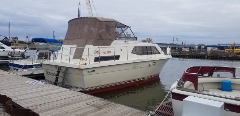

Sorry been absent, work sure gets in the way of living sometimes... We made the trip from Winthrop Harbor, IL to Milwaukee last Saturday. Just under 5 hours. She was launched, took her to the fuel dock, as the previous owner only had left 1/2 tank of fuel aboard (not happy about that (condensation issues)). So I filled her, $498.67... FOR HALF A TANK!!! Anyway, learned quickly we have a few issues. Rudders inop. Stuck mid-ship (thankfully). Amazed at fuel consumption. Pulled into South Shore Yacht Club (I'm a member there, (just don't have a slip there this year)) to refuel. Used 47 gallons to go ~44 miles. so that's ~9.4 GPH. With one drive not working quite right. I have flow meters I am going to be putting on after all the mechanical issues are resolved. So then I'll have exact numbers.
But there is a bigger problem. The port engine would only rev to 1600 RPM in gear. Both engines idle perfectly, and rev great in neutral. Only in gear does the port engine give trouble. This weekend, I'm going to disconnect the prop shaft from the output flange of the gearbox, give them just a bit of space, and see if the motor & gear box wind up correctly then. IF they do, the problem is in the shaft/Cutlass bearing/prop. I have tow new, unused props, untouched from new, still sitting where Trojan put them in the Vee Berth, at the floor. I can always put those on if I think I have an issue with a prop. My brother, a Captain, for the Star of Knoxville, a double-paddle wheeler also suggested making sure the prop shaft is not fowled with a dock line or such, which I guess is possible, but I was on her when she was launched, and I did not see anything suspicious in the water, but still a possibility. The problem is, it is going to take a haul out to see anything in the KK River...
Any suggestions? Also, here is a picture. She will be renamed (the hell with bad luck renaming a boat, that's my middle name)...
