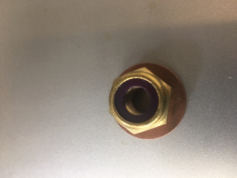

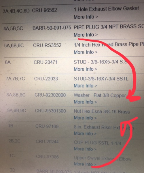

Bob, your pictures illustrate my point perfectly. Those are not the correct nuts but the correct part number, so that's the issue right there. You can see the difference in the size of the nut and the washers in the picture with the studs and gaskets. Even though the image is blurry, you can see that the nuts are much smaller than the washers. A heavy nut is 11/16 across the flats. The washers are just barely under 7/8" so the difference is slightly less than 3/16 over all. The heavy nut when placed on top of the washer will almost covers the entire washer. Also in the picture of the nut alone, the flats of the nut are pretty much flush with the part of the nut that rises up and curves over the top where the nyloc is. On a heavy nut there is a substantial step there.BeaconMarineBob wrote: ↑Sat Mar 02, 2019 8:15 pm Topseaturvy, You should have call us. We have all the Crusader parts and ship to Canada by USPS. We even take your credit card.

Thank you for proving my point. What you and many others are selling as CRU95301300 is not correct. The correct description for CRU95301300 is : NUT,HEX ESNA 3/8-16BRASS 11/16 The 11/16 at the end of the part number is the key, and verifies that it is a heavy half nut.

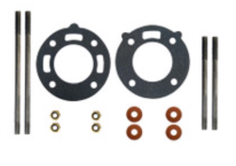

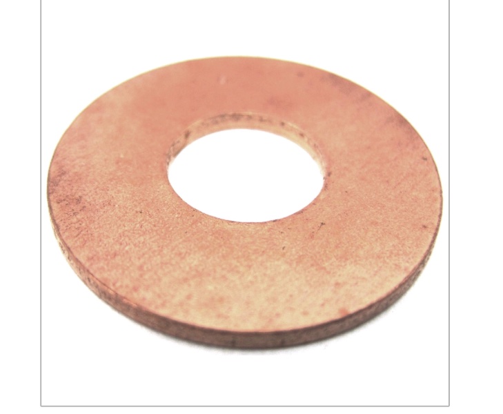

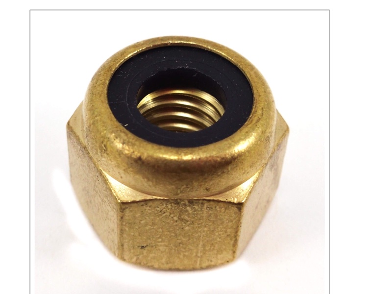

Topseatturvy, I should have been clearer in explaining the pictures. Our you are missing something when you are looking at the pictures I posted.
The picture of the Nut alone is a Hex ESNA 4/8 -16 Brass Nut part number CRU -95301300 this is not a aftermarket nut but a Crusader Marine part from Crusader.
The picture of the washer is a copper flat washer 3/8 which is part number CRU 92302000 which is also a Crusader Marine part and not a aftermarket washer.
The picture of the bolt kit is a Barr Marine part Barr 20 97772P (Crusader Marine does not make this kit.)
This kit probably would not work for you since it sounds like you are using the water jack donut.
We have been selling the Barr kit for years and have never had anyone say the Nuts or washers were not correct or that they had a problem with leakage around the bolts. We have also been selling the Crusader Nut and Crusader washer and again never have issue.

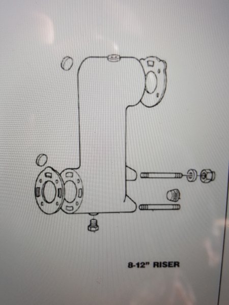

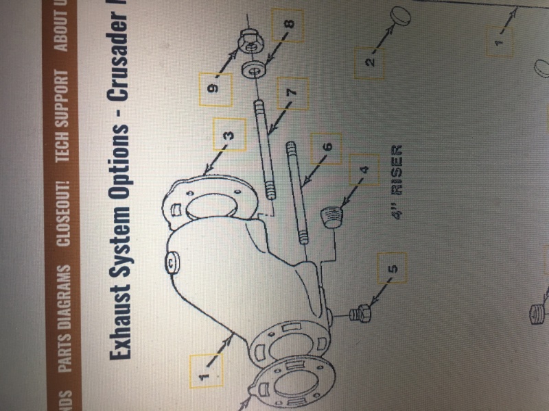

Here is the Crusader drawing

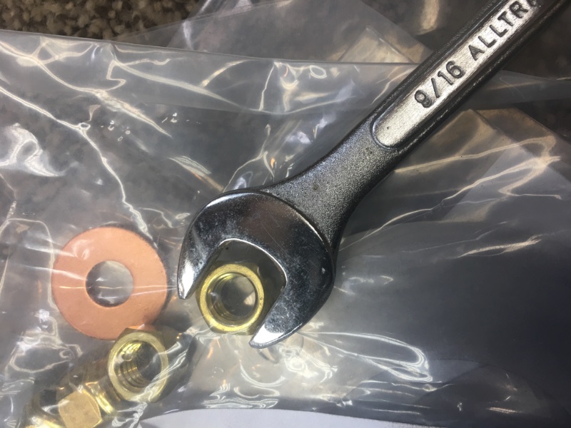

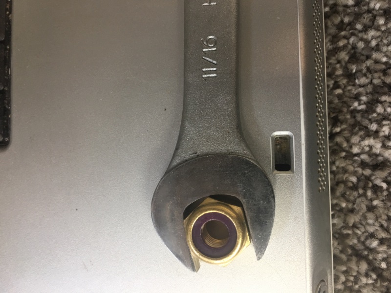

Here is the answer in pictures.
If you buy a Crusader Nut and Washer you will get the big nut which takes a 11/16 wrench.
If you buy a aftermarket installation ket from which comes with studs and washers you get a smaller nut which takes a 9/16 wrench. We sell the Barr kit and have never had a problem reported. We also have the Crusader nut and washer.
In the future if you need a Crusader or Trojan part give us a call. We ship to Canada by USPS and take CC cards.

I like seeing that 11/16" wrench on that nut. I'll be in touch the next time I need those nuts.BeaconMarineBob wrote: ↑Thu Mar 07, 2019 1:41 pm Here is the answer in pictures.
