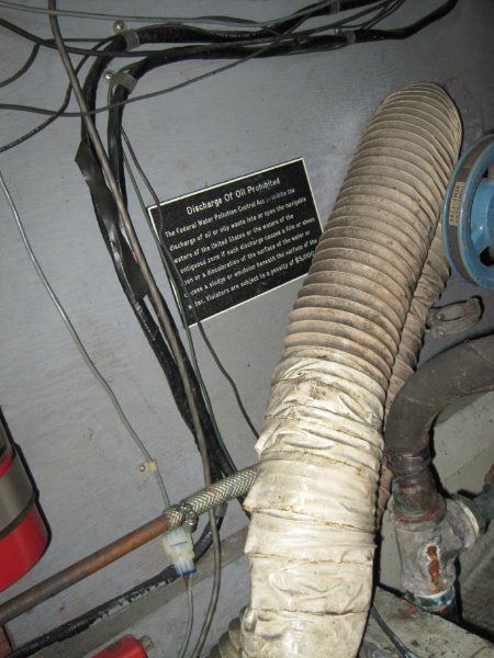

If you use T-clamps in a damp location, you need to be careful with your product selection: https://stevedmarineconsulting.com/hose ... selection/
Make sure you are not using brass shutoff valves with pipe threads to connect to the through hulls. Through hulls come with straight cut threads and you only want bronze fittings. If it were my boat, I would want a shutoff right inside the through hull.
Even worse is putting a galvanized fitting in place. This is how our boat came to us -- note the rusty section of the "T" that was seeping salty water onto the bolts for the through hull!
