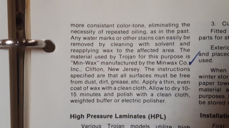

Re: F32 Interior Wood Work
I don't have my owner's manual in front of me, but I swear it says Minwax paste.

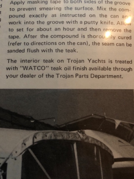

I do have my manual for a 1976 F-32 and it says Watco Teak Oil.

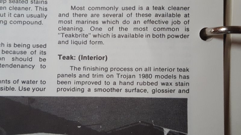

OK, now I do.
- 20190505_161006.jpg (58.35 KiB) Viewed 18076 times
Interesting guys. But I swear my 1976 manual say Watco Teak Oil. Now you got me wondering. I'm going to look tonight.. lol And I do have a can of Minwax paste wax I'm going to take up to the boat for sure... And it does say the finish has been improved so maybe they switched It in the 80s
And for the record, i wasnt being an ass by posting the pic with the checkmark next to the topic of discussion. Manual came with that check mark, no doubt placed by one of the two previous owners having this same conversation with themselves...... In truth, there are many options, and products change or new products with higher performance get introduced. Nice to see folks keeping up their boats, though.

Thanks all for the reply's, but duh! never thought to look at my original manual for the answer.
So it seem's Trojan changed there minds on what to use for the interior somewhere after 1976 and before 1980. BradZ, your not crazy, P-Dogg your also correct. So here is my 1976 manual, WATCO it is!
