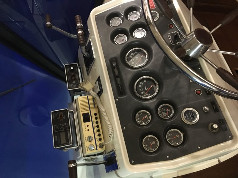

Now that i got the engines running where i want them i want to look at the throttle handles. My issue is the amount of play/slack in them. Definitely is not a cable issue. Looks like some of the rivits have gotten loose or worned out.
Is there any way to tighten them up again? Or am i going to have to eventually change them out?

Rivets ? Any photos of the controls ?

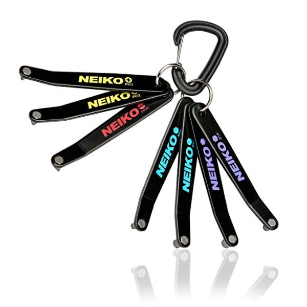

Cappy, I had seriously sloppy handles on the lower helm of my 1976 F-32. I was able to remove the chrome base covers and use a crazy 90 degree phillips screw driver to tighten all the handles. See photo of the 90 degree screw drivers I bought from Amazon.

Brad do you any links for those. Also where did you tighten up in the controller?

Cappy, If you loosen the tiny set screws on the chrome covers on the lower controls. You will then see the Philips screws used to hold the handles onto the control. I bought the screw drivers from Amazon here's the link:https://www.amazon.com/gp/product/B078M ... UTF8&psc=1
