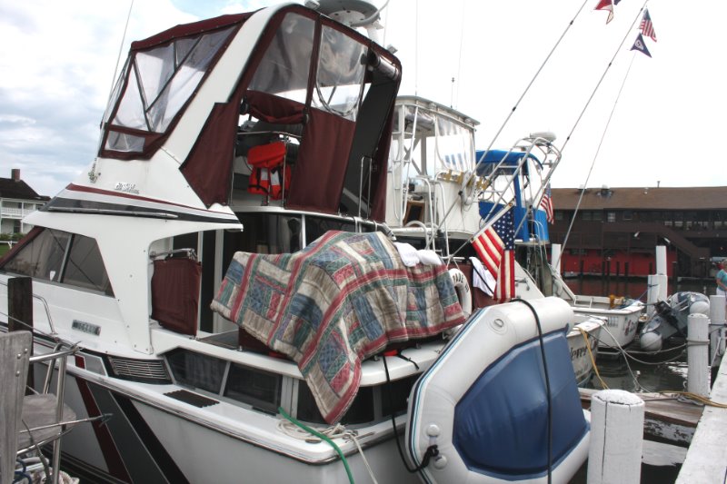

Here's a photo of an aft cabin model located at www.trojanboat.com:

Re: 89 10 meter bilge pumps
They also made a Flybridge aft cabin . But I believe they were only made in the earlier 80s .
- Trojan trip ( wes photos) 120.jpg (90.92 KiB) Viewed 9567 times
