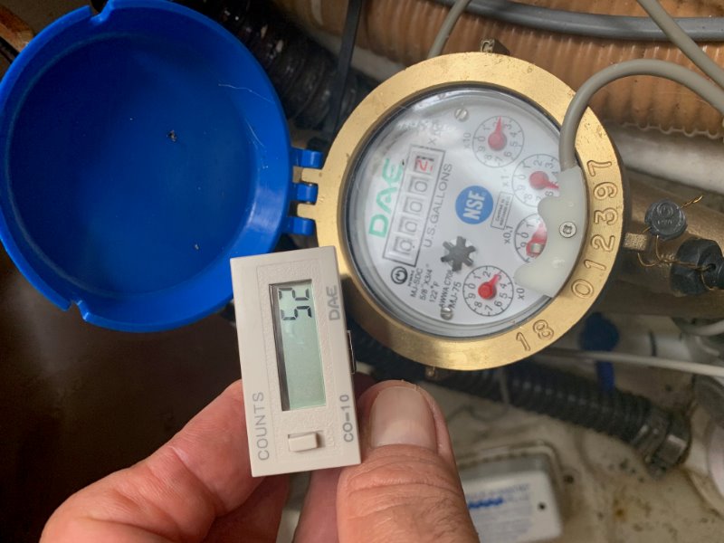

I recently added an actual water meter to my fresh water tank.
I can confirm that on this 1983 International Express Cruiser the fresh water tank capacity is actually 52 gallons.

What type of meter ? Photos of install ?
Re: International Express Water Tank Capacity
this photo is turned sideways, it's actually reading 52
purchased on Amazon.
Installed in the forward bilge located in the cabin
Moved stainless steel strainer upstream of meter
I will be mounting the digital readout up in the galley
meter $75
pulse counter $38
peace of mind on the hook = PRICELESS

How does the pulse counter register gallons in the tank?
you don't NEED the pulse counter
It does, however connect to the actual meter, and gets it's data from there
So fill up your fresh water tank, reset the meter to zero, then run her bone dry = 52 gallons
So it is from the same company and designed to work with that meter? That explains it all...
