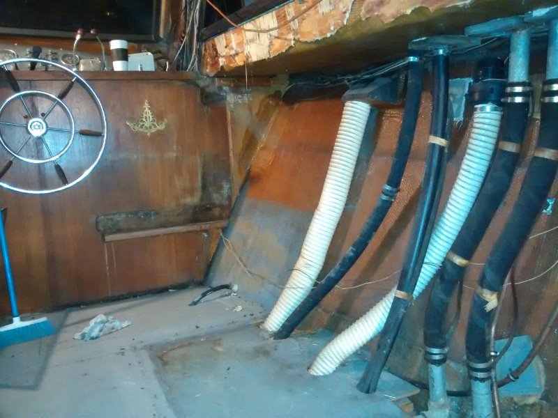

Hi Dragon, I have a 1977 Tri Fly and there was a small holding 30Gal tank on it under the floor by the lower helm, starboard side.
The deck fitting was the forward most fitting, then water then 2 fuel fittings.

Come to think of it now, It didn't look factory. It was a different fitting and didn't have the plywood backing plate under it :?
