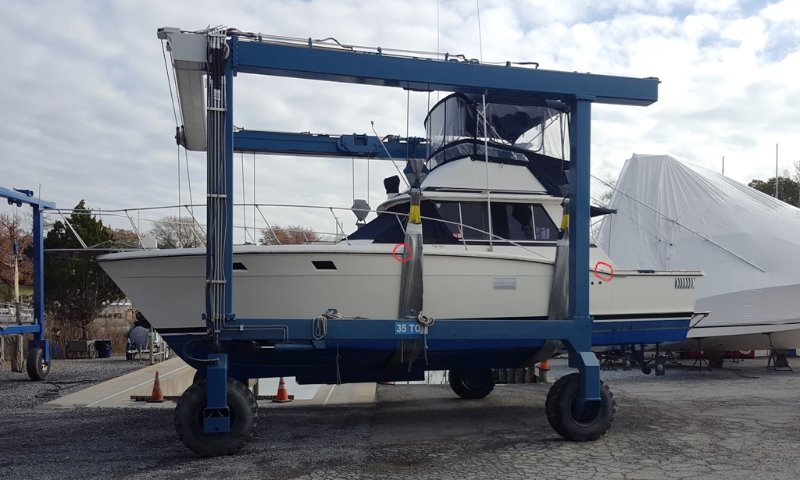

Here is a picture of our boat on a travel lift with the factory specified locations circled in red. The travel lift operator was not comfortable with the specified rear location and I couldn't get him to use it.

Re: Twin engine, dual battery hookup on F 36
WayWeGo wrote: Tue Sep 17, 2019 9:05 pm I believe the batteries are always put in parallel when starting the engines and the emergency start switch is actually a backup system in case the rectifier that parallels the batteries fails.
Or when youre in a bad way and you need to combine the batts to transmit a mayday. IIRC, my manual indicates what WWG said about always starting in parallel is correct.

Hi guys, thanks for the mail. The picture of your boat in the travel lift is perfect! Pretty much what I'd have guessed, but always nice to get it straight. I appreciate it. Have a good nite, Dave
