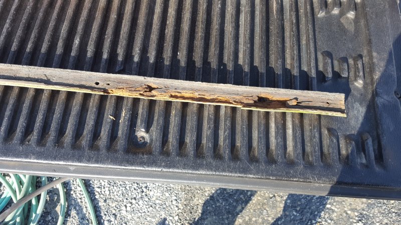

Re: leak
If you are inspecting your rub rail, it might be worth it to remove a section to see how the wood is holding up. On our 1975 F-36, the teak looked fine from the outside, but the inside was rotten away. As a quick fix, I replaced a small section near the sling points to protect the hull. At the next haul out, I will be installing synthetic rub rail and reusing the stainless.
