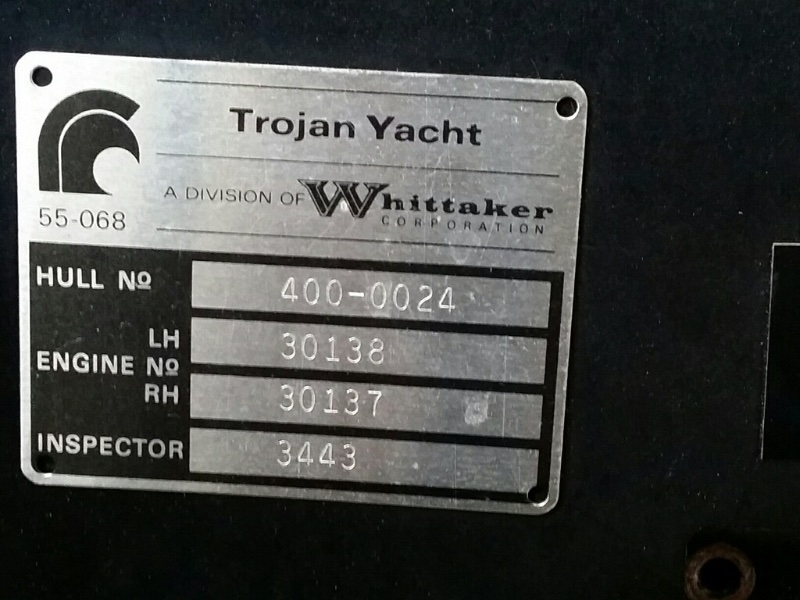

As stated in the other posts the fresh water tank is on starboard side directly under the AC / DC panel and is a fiberglass tank which is fiberglassed to the Hull. It has a plywood top. The whole salon floor can be removed.
The owners manual for your Tri Cabin comes with the electrical drawing, the original invoice and around 100 pages of information on each system of the boat.
Here is the link to the Owners Manual
We would need your Hull number to make one for you.
Your Hull number is on a aluminum plate by the AC / DC panel
https://www.trojanboats.net/zencart/ind ... cts_id=615

Thank you Rick! I did what you said and the best I could see is that the tank must be extended range fuel tanks. What plumbing I could see, is all fuel related. I am going to post the numbers on my boat if anyone can come up with something. I have the Thetford pump out type of toilet,kinda looks like a porta-pot , which I'm going to change ASAP. Thanks again for all your help! Rhino
Re: 36 tri-cabin fuel tanks
I Believe the owners manual will have all that info , check with Beacon . Photos of the tanks ?
