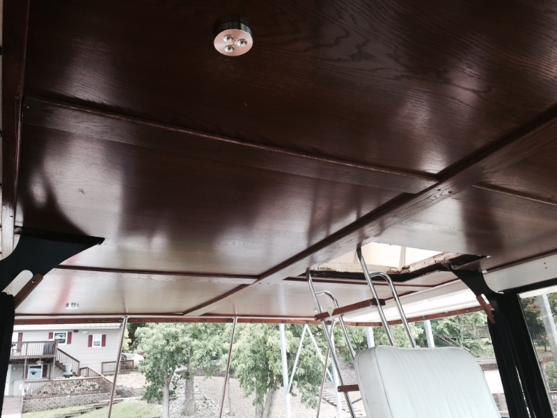

I had to repair a previous owner repair and used white oak sheets that I coated with epoxy on the back before installing. Then stained and varnished to match the other wood.
