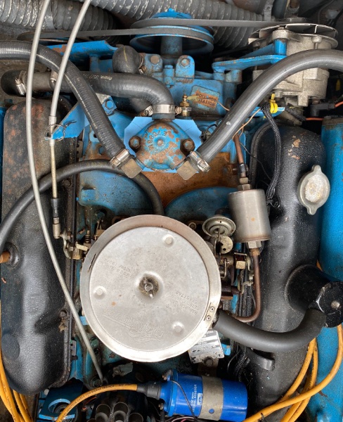

greetings,
where can i find the 1977 Chrysler 318 oil pressure sensor that goes to helm gauge.
thanks!
Svend
1977 318 top view.jpg (159.22 KiB) Viewed 4850 times
1977 Trojan F30 Express, With Dual 318's with Electronic Ignition
Raymarine EV 100 Auto Pilot
Re: Oil Pressure Sensor location 318 , 1977 vintage
Back of the engine near the distributor .
Svend
Posts: 101
Joined: Fri Jul 22, 2016 8:58 am
Location: Gilford NH
Post by Svend »
thanks!!!! I think i see it under the electronic ignition... as usual , not a great place to get to! engines should do a stint as a mechanic, then design engines!! lol

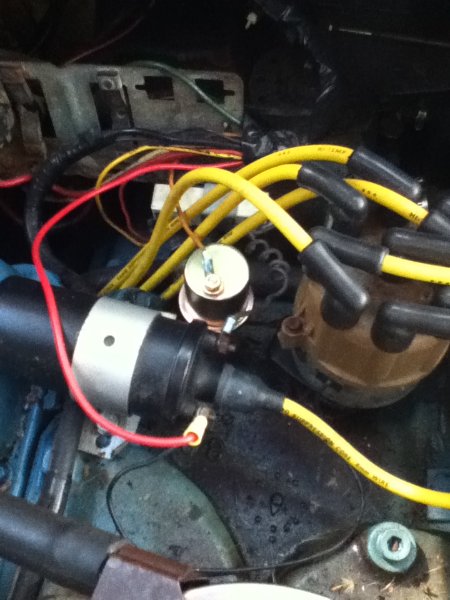

Post by The Dog House »
It's next to the coil and distributer.
