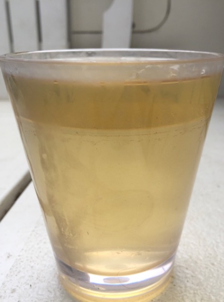

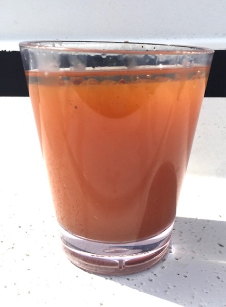

Got up to the boat today. Removed and replaced the water filter from the gas line. Rust colored and some crud on top. Filter had not been changed since 6/19. Cleaned air filter/flame arrestor and carb. Ran engine after replacing filter and it bogged down, stalled and then came back to life and ran fine (in neutral, 1000, 2000, 3000 rpm). Shut her down and removed new filter. Gas looks clean and clear, no water. I filled 50 gal tank last year with non-e gas and it ran fine all last year. Pics attached of filter results. I don’t THINK that layer on top is gas and the one on the bottom is water......if it is then I’ve developed a new fuel based on 90% water...... Comments? Ideas? Thanks!

Well, duh.... That picture I shared of the light yellow gas sample? Yup, that big bottom layer is WATER. Gonna have tank drained of as much water as possible and then BUY A NEW FILLER CAP O RING! Gas is non ethanol but not impervious to water coming into the tank during rain storms from a filler cap with a shot o ring. Cheap part. Expensive lesson learned :roll: :roll:
