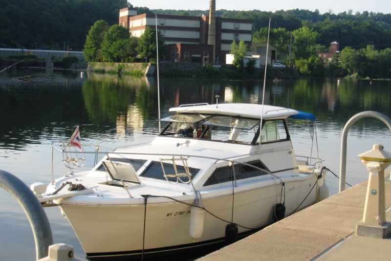

AND FINALLY....walk around on the deck and be aware of any soft spots. The hull is solid fiberglass but the decks are fiberglass over balsa core. Lots of places for water to get into that core over the years from unsealed fittings. If you can do repairs yourself you’ll save beaucoup bucks. Is this the one in Yachtworld in South Yarmouth, MA? If so that hardtop was added to an existing Express model. Here’s what the 1977 F26 Hardtop looks like before Bertram bought Trojan
‘77 F26 HT Since 1999
Re: Considering a 1986 F27 but...12MPH top speed?
Boppy wrote: Thu Aug 13, 2020 9:36 pm AND FINALLY....walk around on the deck and be aware of any soft spots. The hull is solid fiberglass but the decks are fiberglass over balsa core. Lots of places for water to get into that core over the years from unsealed fittings. If you can do repairs yourself you’ll save beaucoup bucks. Is this the one in Yachtworld in South Yarmouth, MA? If so that hardtop was added to an existing Express model. Here’s what the 1977 F26 Hardtop looks like before Bertram bought Trojan464DCDBA-981C-4B3A-A782-11A6EBB0E2A2.jpeg
