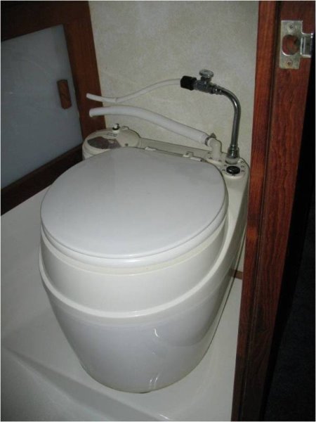

Like Prowlersfish said, this is a recirculating system.
You will have an incoming water feed to the head that goes to the right hand side (looking at it from the front). Just to its left will be a vent fitting that goes out through a through-hull. You may (should) have a shutoff valve for the water feed, so need to open it when you want to prime the head then turn it back off afterwards. Plumbing to that infeed probably is just a carry on from the cold water line to your faucet in the head.
Here's a pic of what I used to have (replaced with a macerating unit a couple years back). How the system works:
- The head needs to be 'primed' with 3-4 gallons of water. Open the valve and let water pump in until you don't hear the sound of 'bubbles' anymore.
- That means the outlet end of the feed line is not just pouring more water in, but is now under water in the reservoir, so the reservoir is primed. [think: use a hose to fill a bucket with the end of the hose a few inches above the bottom of the bucket... lots of splashing / bubbles as things fill up, but once the end of the hose is under water it gets very quiet - THAT'S what you are looking for]
- Once primed, the flush button on the back left section of the head can be used to pump / recirculate the water to 'flush' the system. Anything flushed goes into the local reservoir.
- Pour in toilet chemical (liquid) to help deal with odours etc (google or your local marine supply place for the right stuff), or if powder dump it in the bowl and flush it through.
- As you use the head, liquid and solid waste goes in to the local reservoir. When you flush, fluids (what was clean water + head chem + pee) is used to flush / rinse the bowl, solids remain below.
- Once reservoir is full, or things smell too much, time to empty the head!
