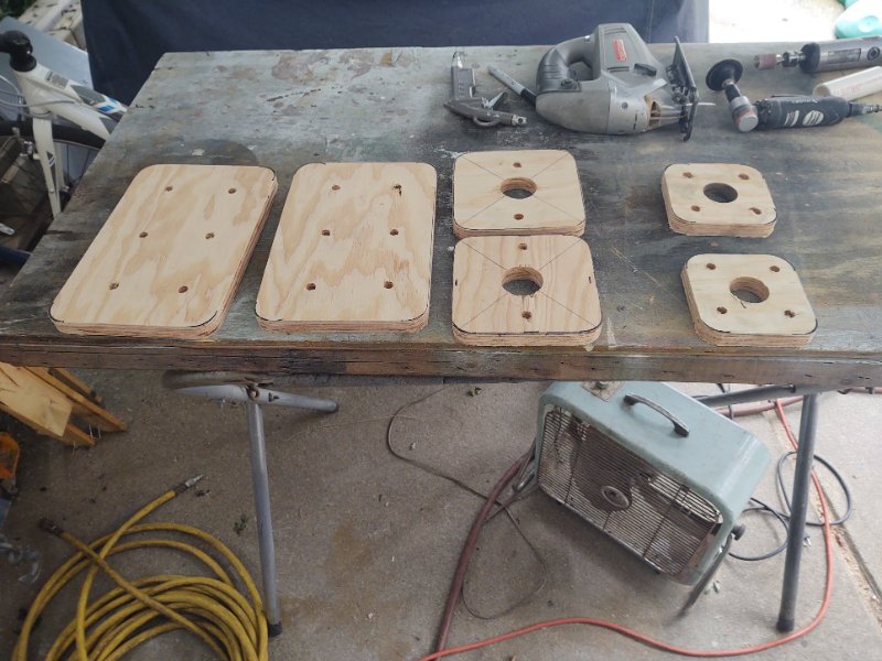

I just recently removed all the wood backing plates in my F32. The struts, rudders and fresh water valves. Im using 3/4 inch marine ply and they are slightly larger then the fittings and I rounded the corners. Off hand I don't know the dimensions of the bolts. I can measure them later today for you.
Of course you will have to release and drop the bolts then chisel the wood away and then scrape the adhesive off. Then grind and scuff clean the surfaces for the new application.
