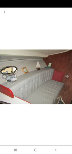

I'm looking for the bed bracket / bar for the bed in the cabin. Anybody know where I can get it?? As in the picture the previous owner made it in to a couch I want the bed back. Any help would be great. Thanks.

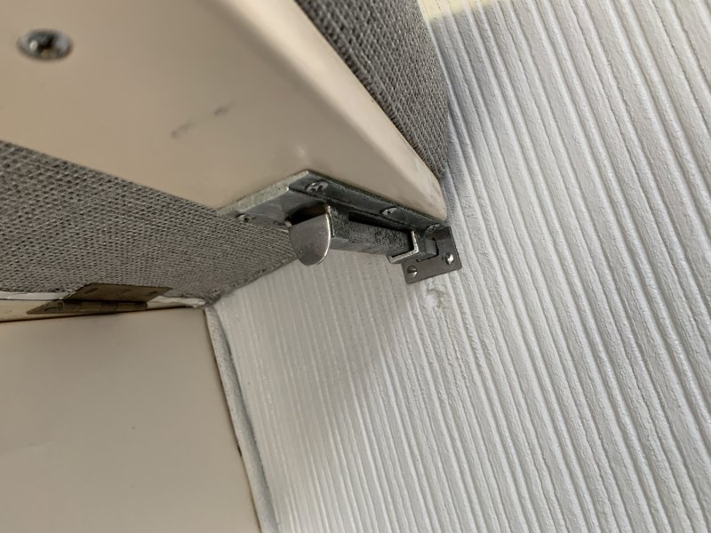

Do any of you guys have a pictures of this boat with the bed in it? Or can get some pictures of the hinges that are used to secure it to the wall pockets? I did talk with beacon today. He's looking to see what he might have.

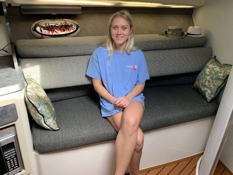

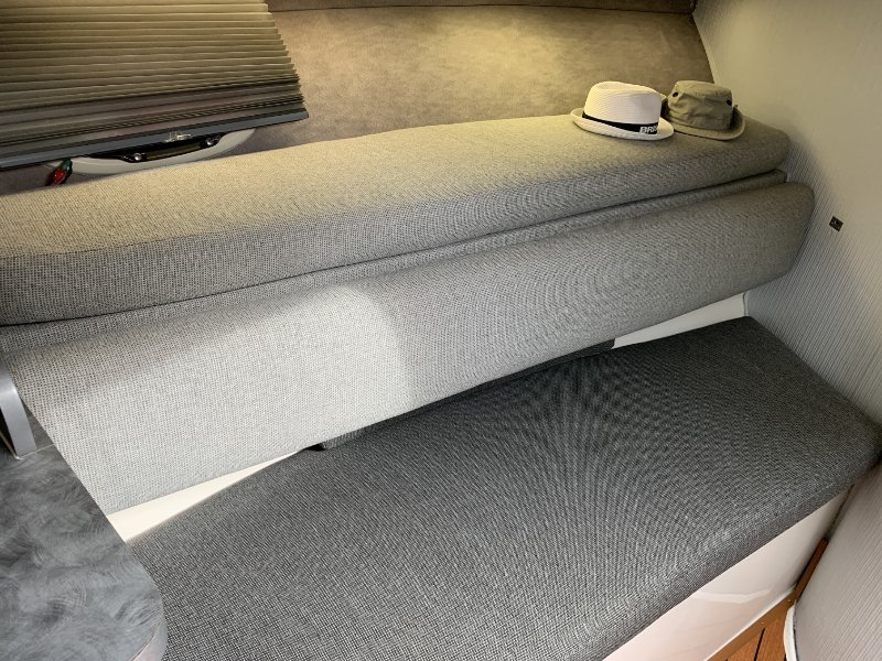

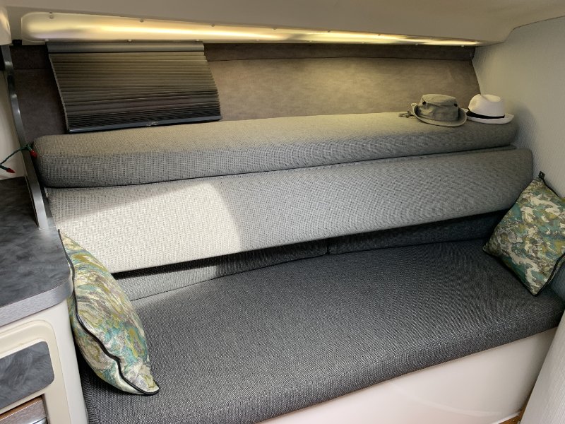

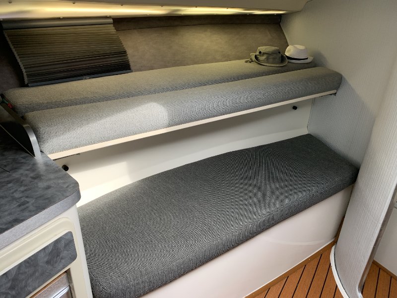

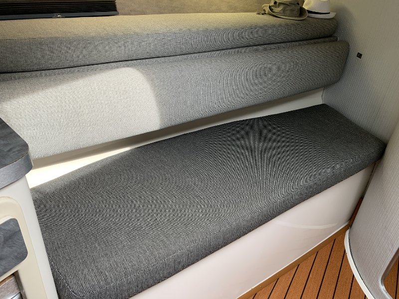

heres some photos of how it looks on my 10 meter

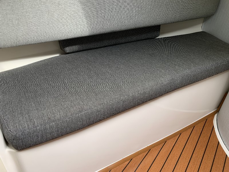

from the factory both dinette filler cushions would easily store behind the hinged drop bunk/sofa back
when we redid my cabin interior we made the cushions a bit thicker, now one stores fine, with 2 it sticks out a bit

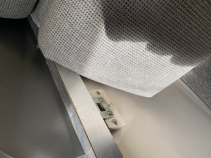

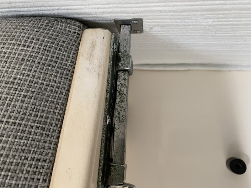

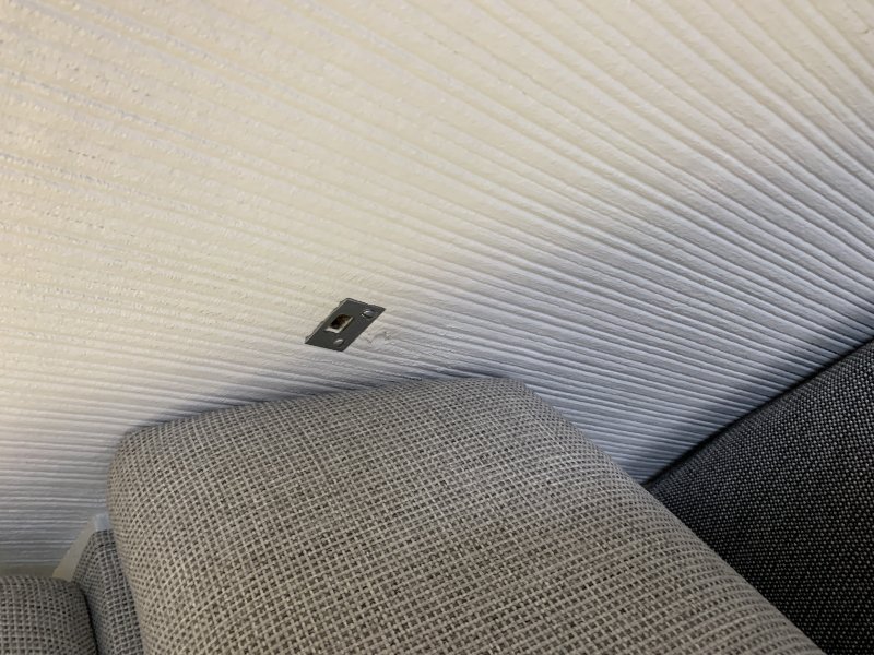

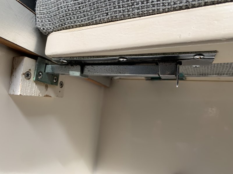

factory slidebolts and receivers on both sides allow for an anchoring point
keep in mind, nothing, NOTHING is a straight line.....

That helps out alot!! Thank you so much!! Time to start building.
