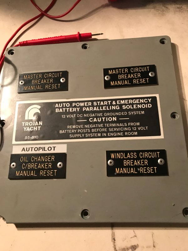

Solenoid will be in this box
trojan box.JPG (80.49 KiB) Viewed 9553 times
Re: emergency power
Another pic
trobox 3.1.jpg (38.71 KiB) Viewed 9533 times

Prowlersfish you are a genius. All the labels had been taken off my box, but your picture helped me find it. Now I will see if it is working. Thank you so much for the info. :D

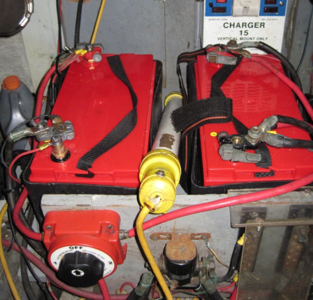

Interesting! My solenoid is not in a box -- it is on a plywood board right in front of the batteries. Here is an old photo from before we bought the boat. The solenoid is to the right of the battery switch on the rusty bracket.
Battery Switch.jpg (91.17 KiB) Viewed 9431 times
Re: emergency power
WayWeGo wrote: Fri Feb 05, 2021 11:21 am Interesting! My solenoid is not in a box -- it is on a plywood board right in front of the batteries. Here is an old photo from before we bought the boat. The solenoid is to the right of the battery switch on the rusty bracket.
I would up grade that solenoid , ground is a poor set up .

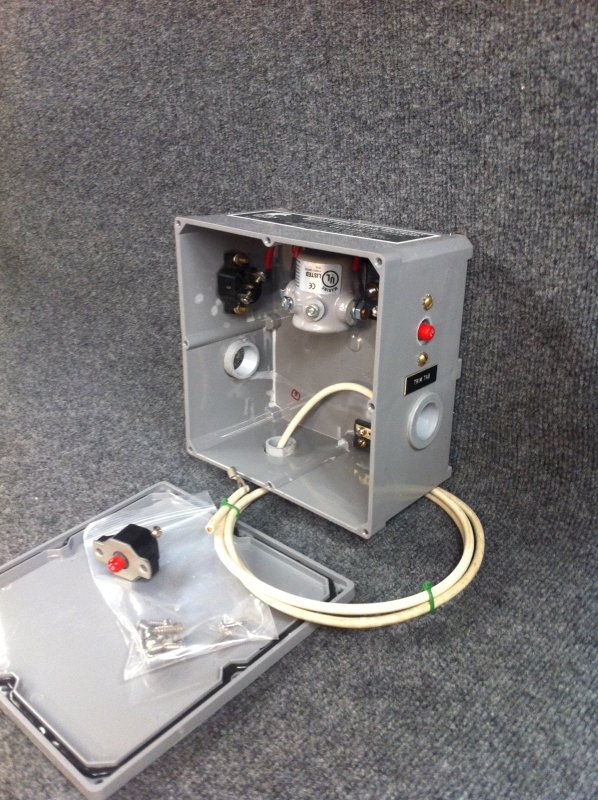

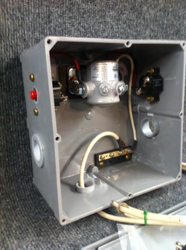

Beacon , offer replacement boxes
trojan replacement box 2.jpeg (102.16 KiB) Viewed 9405 times
trojan replacement box 1.jpeg (135.52 KiB) Viewed 9405 times
Re: emergency power
prowlersfish wrote: Sat Feb 06, 2021 10:21 am I would up grade that solenoid , ground is a poor set up .
It has already been cleaned up partially, but there will be some more done when I replace all the wires to the batteries and add some terminal blocks and fuses.
While the original wiring is mostly intact, the wiring for added devices is pretty bad on even the better additions!
