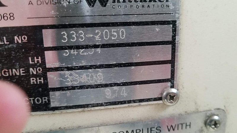

Can you get me the numbers of your ID plate? It will be under helm in the doors to the pannel I will find what Trojan put in it new. Only 2.0 gears are listed for the express , but if there was something odd on a boat it will be on the paperwork. I will get Bob/John to check it when I get your numbers.
ID plate looks like this
- Trojan id plate.jpg (121.94 KiB) Viewed 12719 times

I will get the numbers off the plate. Thank you all for your time and knowledge.

Hull No. 333-2050
LH: 34257
RH: 33409
Inspector: 974
Thank you.

I sent it to Bob and John, But are you sure about the 333 (Hull No. 333-2050 ) ?
