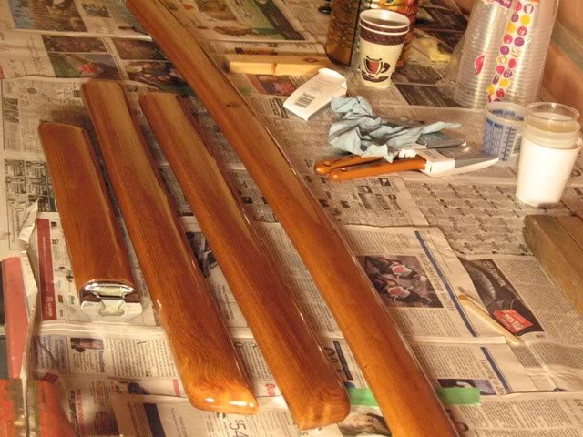

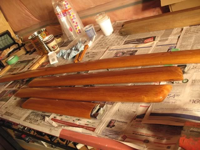

Varnish - Interlux Goldspar - Stern railings
  • About 7 coats previosly applied lasted about 3 years without problems. Saw some cracking in it last fall so decided to give it light to medium sanding and just finished applying 5 fresh coats. I will give it a week to cure fully before I reinstall the railings.

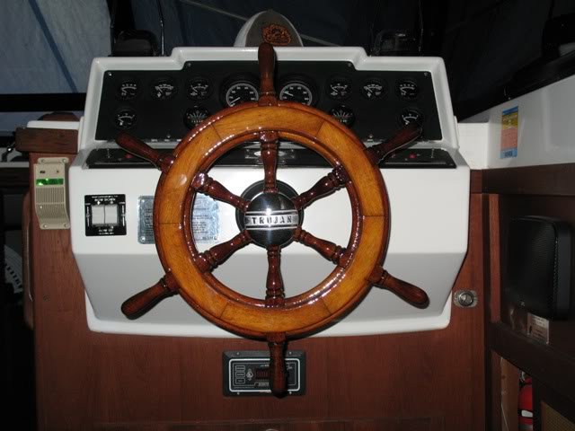

Varnish-like - Epifanes Wood Finish Gloss - Wheel
  • I don't think this is a true varnish (no sanding required between coats !!!!) - more like a varathane. 6 coats applied about 2 years ago, no maintenance will be needed for a looong time. Incidentally, the wheel was rescued from my father's old 1969 28' Sea Skiff, and looks right at home on my F32 (aside from the custom hub adapter I had to design and have made).
