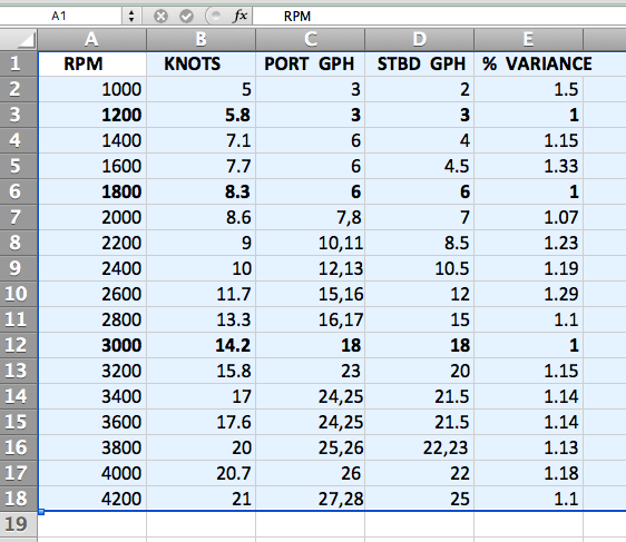

I have attached the results of the most recent sea trial

Check your timing with and without the missing spring. You say you swap carbs with the same results? Is your fuel burn difference conferred when you fill-up? Fuel on the water only at idle speed? The thing I find odd is the big difference at some rpm and a match at others. Let us know what happens with the spring.

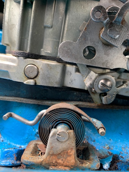

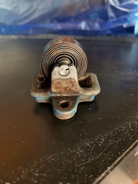

I am attaching a photo of the stretched out starboard choke coil
and the wound tight port choke coil
The starboard coil binds up in its housing
I have not been able to get it off yet
I hope to straighten in out
I am thinking of lengthening the linkage on the port side so it will start out leaner

there seems to be left and right versions of those choke coils
also crusader has two part numbers listed, one for 0 angle and one for 12 degree down angle according to a post I found on another forum
today I started both engines without the chokes
no problem
that's the solution for now
thanks everyone
