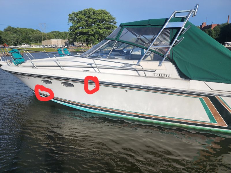

Checked for the pump with no luck. I found 3 hoses and traced them out. The 1st one just drains into the floor to the bilge pump, The 2nd is where the fresh water is discharged towards the front of the boat, the 3rd goes back to where the steps are and goes out of the boat. The red circles on the picture shows those 2. I remeber winterizing it and the water came in towards the front of the boat. Am I missing an access panel somewhere that I'm not seeing?

The fiberglass filler panel above the aft gunnel indicate this is not an express.
It's a mid cabin.
Perhaps Bob Dunne will chime in here.
