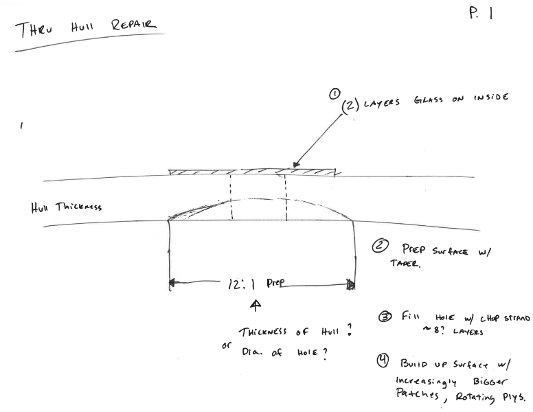

My Main question is the 12:1 ratio. Is the "1" the
-thickness of the hull (assume a 1" thickness, then the taper/prep area is 12" wide?)
or
Diameter of hole repairing- (assume 3" diameter then the prep area would be 36"?)
question 2: Taper both the inside and outside to meet in the middle?
Also, I'm slightly concerned about 'tapering' the hull all the way through the thickness... These Trojans are THICK. I understand the theory of a tapered hole on both sides to keep the 'plug' from ever coming out, but is it really necessary to take the parent material (original hull) all the way down?

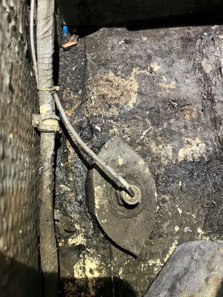

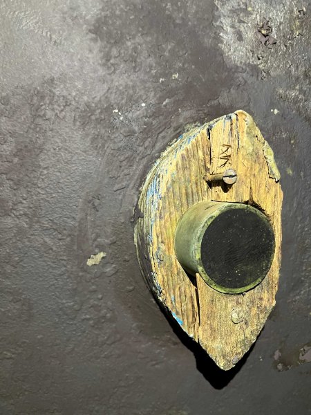

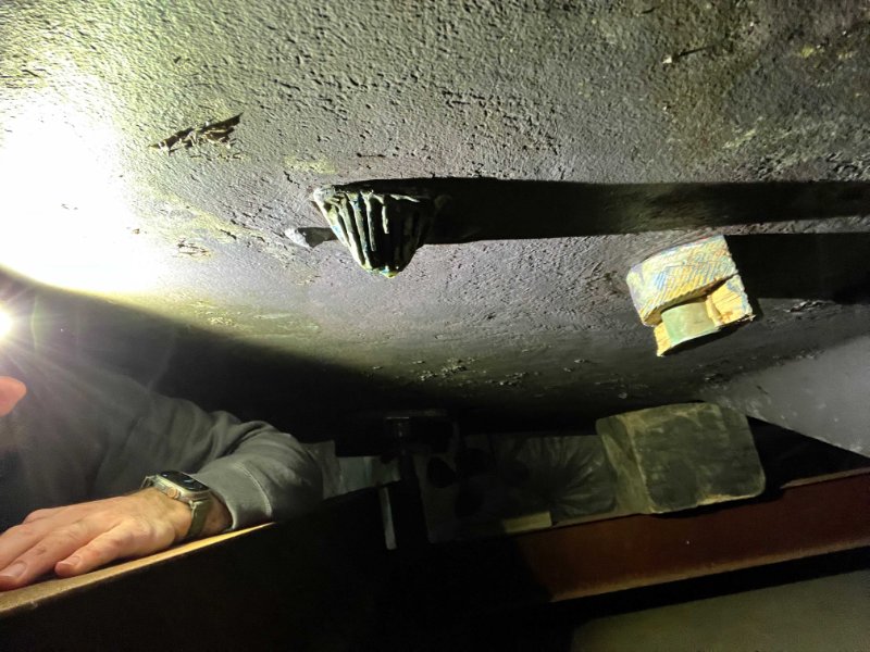

Thru hall 1- as viewed from underside of boat
Thru Hull 2 - as viewed from inside
Thru hall- underside far

- the plan
- Thru Hull Sketch.PNG (72.52 KiB) Viewed 12629 times

The 12 to 1, I believe refers to the hole Diameter. I also believe 12 to 1 is way overkill for a small hole like this. I would taper the hull a bit and grind some around the edges ( not as deep as your drawings ) fill and glass over. I have done this more than once without issues.

First off, I align my thoughts with prowlersfish - I am very focused on retaining history and keeping my boats as original as possible, but my mindset has always been to upgrade obsolete technology, especially when it is safety related. I would recommend you get yourself a more modern Depth / Speed or forward projection / side scanning sonar and head and transducer(s). Upgrading safety equipment is never a mistake. It keeps people alive.
If you choose to stick with what you have, maybe I am not seeing it right, but doesn't look to me like you need a whole scale hull repair. Looks to me that someone crafted and fared / shaped a block to fit the transducer and reduce drag. Also appears that what they built used several pieces of wood (laminated together to give the required depth), and only the outer / lower piece has failed based on what has chunked away. I don't see a fundamental fiberglass / hull failure issue here.
From the pictures, it looks to me like the block was constructed by cutting several pieces out of a piece of (hopefully) hardwood, drilling a hole to fit the transducer in each, and then laminating or screwing them together to build a hydrodynamic and protective block to house the transducer (less resistance when running, and haulout straps on the wood don't crush the transducer). My father's '69 Trojan had a depth transducer set up in a similar way - a 'torpedo' styled block was mounted under the hull to protect the transducer and make sure it pointed in the right direction.
In the pictures, it appears to me that the lowest laminated piece is screwed into the next piece, and (where the lower chunks of wood are gone) the next piece seems to have a very flat surface - so seems more likely a laminated situation than a block of wood that just split TOTALLY HORIZONTALLY.
Could you pull the screws, push, pry or chisel the lowest level piece of wood (laminate) off, and just replace it with a new piece of oak or ??? cut and shaped in the right depth, with appropriate hole size cut in the middle for the transducer, epoxied and screwed in to existing block?
New instrumentation would be my recommendation, but failing that I think you just need to replace this piece of the 'torpedo' encompassing the sensor, not redo the entire thru-hull fitting, because the rest looks intact.
May be dead wrong, but that's what I see.
