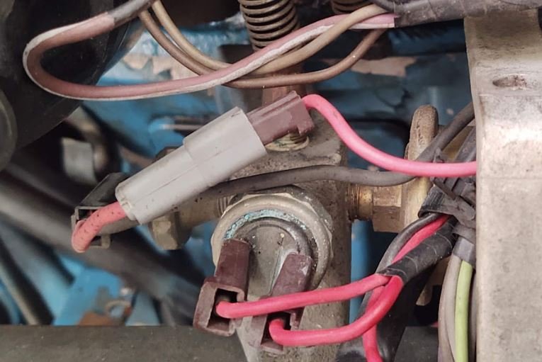

Going to check the wires and connections on the senders.
oil sender and switch.JPG (66.86 KiB) Viewed 13566 times
