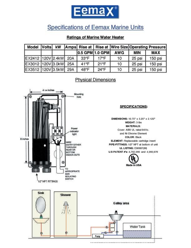

Just not sure if the .5 gallons per minute would be enough for a shower. The faucets would be fine but the showers might not tolerate it.
Something like this maybe
http://www.pricelesshomecenter.com/prod ... category=0

Do you really what a water heater that you can only us when you shut off everything else in the boat before you use it ? you want to take a shower so you turn off the a/c , tell the wife to stop cooking ? The water heater you have now draws maybe 15 amps or less. ( mine is 12 amp) .
Also those units can only heat up the water so far if your water in the tanks is very cold you may not get very hot water , if the water in the tanks is warm you could get burned , scary if you have kids
