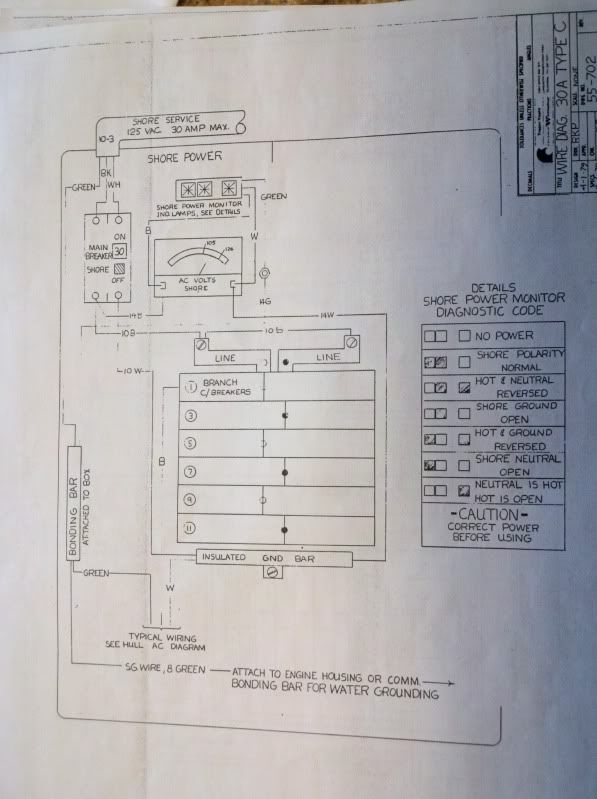

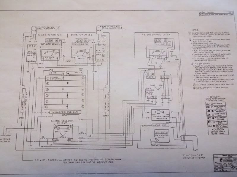

I have the schematic if you want. I can fax it, maybe it'll help. Line 1 and line 2, each separate into the fuse panel via indivual main breakers.. On my boat one line services starboard receptacles, one line, port with air conditioner on line 2. Water heater is on line 1.

This is what I have. If you'd like a fax, email me at my address in my signature.

Actually, Jaime the pictures of the diagrams you posted have enough detail for me to see. My boat is much older so some of this doesn't apply but I can get some generic AC feed info out of it. Thanks!
