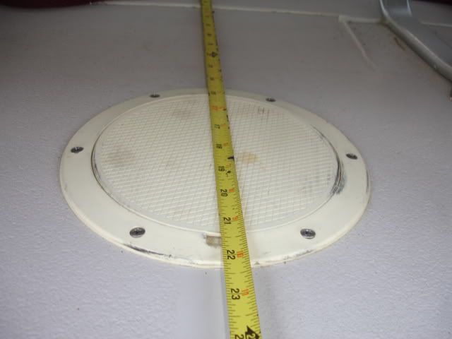

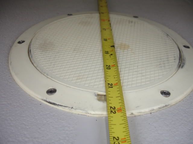

Toward the rear of the cockpit sole, on center just behind the leading edge of the bench seat on the express cruiser version.
I will try to post a picture sometime next week and will lay out a ruler on it.
The starting end of the tape measure is up against the rear of the cockpit floor.RWS wrote:Toward the rear of the cockpit sole, on center just behind the leading edge of the bench seat on the express cruiser version.
Looking at the photo tells me that the fitting has yellowed quite a bit since it was installed in about 2001. Time for some of that Krylon plastic paint.
Sorry it took so long to get this up on the Forum
Here 'tis.

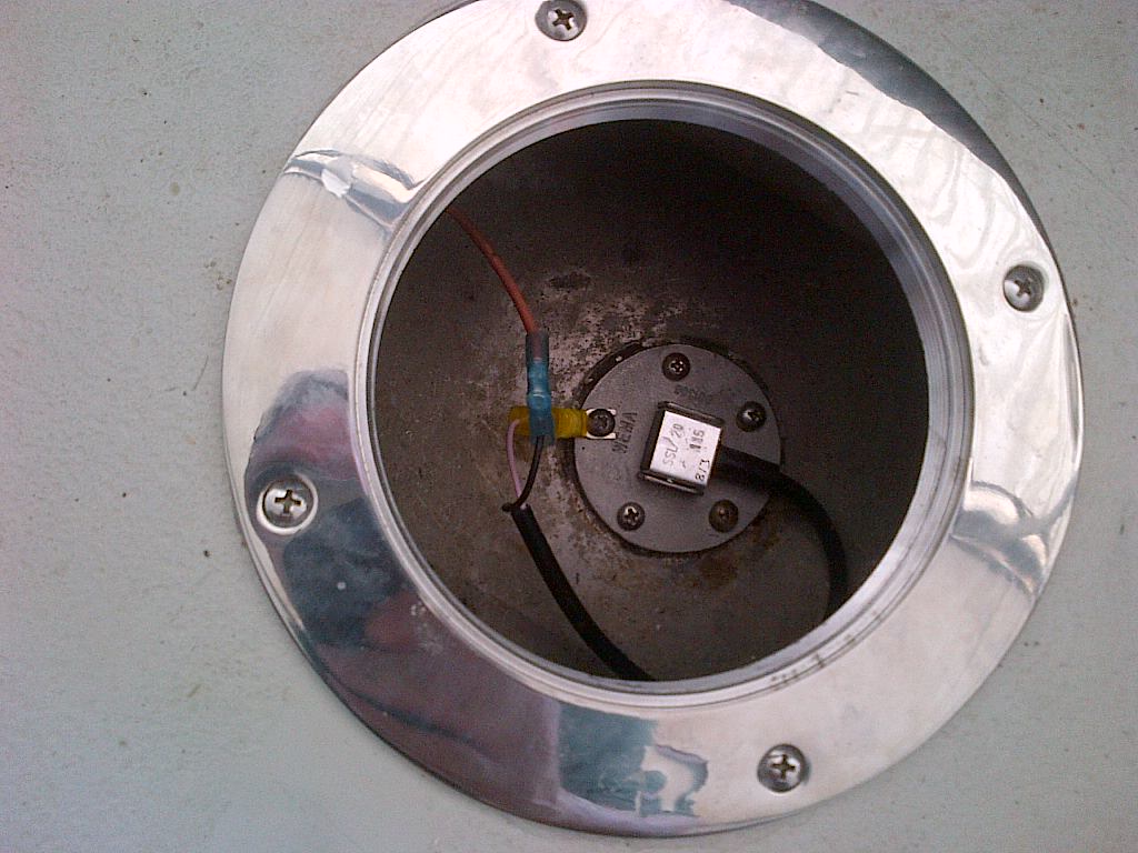

Thanks for your help RWS. It was painful to cut a 5" hole into my rear deck. It will be worth not filling up every other trip for fear of running out of fuel. I am replacing the connectors when I get back from West Marine.
