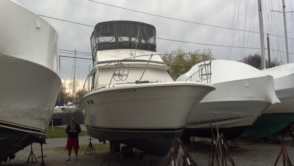

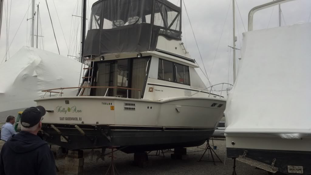

jeffsock wrote:Here are some pics
http://i1062.photobucket.com/albums/t49 ... tfront.jpg
http://i1062.photobucket.com/albums/t49 ... 54_442.jpg
Wow..she is great looking
Her exterior looks well taken care of
Thanks for sharing the pics

Price sounds low to me, but it's hard to tell real condition by the pics. It certainly looks good, and in the pic where someone (you?) are standing beside it, it is clear that you have that 'late 70s/early 80s' gelcoat that still holds a great shine. It could be one heck of a deal, or the pricing may reflect that salt water has taken a toll, and if the genny is out I would wonder what else the previous owner has done mechanically. Survey and mechanical inspection are definitely important here, to make sure you have the best possible understanding of what you are looking at.

It looks like you have the extra pair of fuel tanks (I see 2 vents in the pics), and that is a big plus. You will carry 220 gallons total (110 / side). The 'base' tankage was only 60 gallons per side, but with the extra tanks you got another 50 gallons per side. At (roughly) 1.1 mpg total at cruise, the extra fuel really helps with range.
