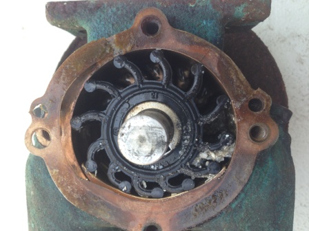

The river I boat in is only about 4 feet deep in most spots. The channel is around 10 feet deep but if you venture out of it at all you are liable to encounter some shallows. So while leaving a nice beach spot on Saturday I sucked some sand up into the port engine raw water intake. The engine temp started shooting up so I shut it down and motored home on just the starboard engine. When I pulled the raw water pump to inspect I immediately discovered what had happened.
I pulled the oil/transmission cooler as well figuring that quite a bit of sand got pushed into it. There wasn't any sand noticeable in anything downstream of the cooler so I think that's as far as it got. My plan is to rebuild the raw water pump with a new seal and bearing. While I've got the cooler out I figure now is as good a time as ever to replace all my hoses and flush the cooler.
Can anyone recommend what exactly I should use to flush the cooler? Is there something available at Lowe's or Home Depot that will do the trick?
I noticed the pump was leaking from the bearing/hub side so I figured the seal was destroyed as well. Found the pump was pretty much clogged with sand. With the pump apart I found the bearing was also clogged with sand and had started corroding from the saltwater getting past the seal.I pulled the oil/transmission cooler as well figuring that quite a bit of sand got pushed into it. There wasn't any sand noticeable in anything downstream of the cooler so I think that's as far as it got. My plan is to rebuild the raw water pump with a new seal and bearing. While I've got the cooler out I figure now is as good a time as ever to replace all my hoses and flush the cooler.

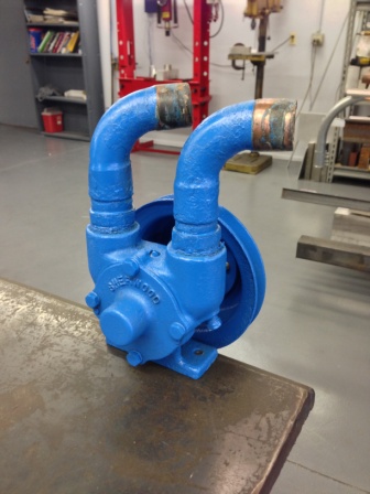

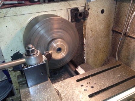

Water pump rebuilt and ready for installation. Replaced the bearing ($14) and seal assembly ($25). Also faced off the cover plate because it had a pretty deep wear groove in it. New coat of paint and it's ready to go!
- IMG_1773.JPG (75.71 KiB) Viewed 10629 times
- IMG_1781.JPG (60.87 KiB) Viewed 10629 times
