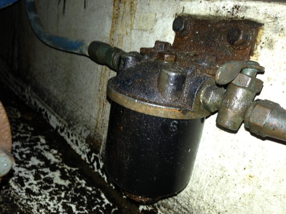

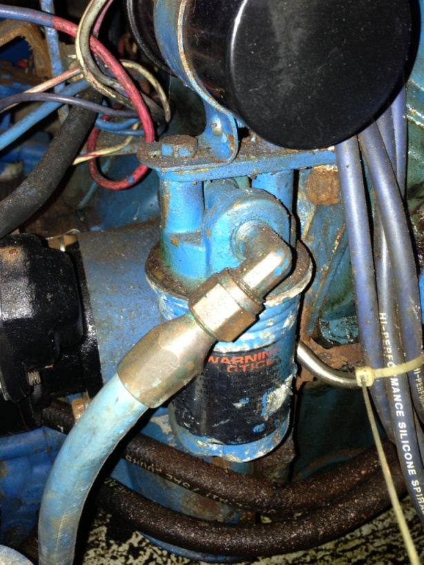

Time to change my fuel filters. There is one mounted to a stringer and downstream of that is another mounted to the engine. Any advice on how to remove and replace these? Do the canisters screw off? Does anyone recognize them enough to tell me where to find a replacement cartridge?

The top filter mounted to the stringer looks similar to my fuel filter. My filter housing does look longer though. To change the fuel filter, shut off all of the fuel valves. Next, remove the screw at the bottom of the housing to drain the fuel into a suitable container. After the housing is empty, use a strap wrench to unscrew the housing from the top part that is mounted to the stringer. My fuel filter uses a Fram CCS1136 filter element, but I would open your filter up and see what is in it to confirm. Your housing looks shorter than my housing.
The bottom filter looks like a standard spin-on fuel filter. Can you see any identifying marks on the current filter? I can't tell from the picture what the specific part number is.

The first filter in the pictures is a water separator/ fuel filter. To replace it, loosen the 9/16" bolt on the top while spinning the canister loose. Inside will be a filter, Napa number CP 3110, available at most Napa Stores.
The second filter is a Crusader filter, number 91606 but you can get a Sierra filter, part number, 29404 at most boating stores. To replace this filter, take a pair of channel locks and lightly grip the canister and turn counter clockwise to loosen, then simply spin off. I find that you only have to hand tighten this canister when done. Don't forget tho replace your carb inlet filter while you're in there...

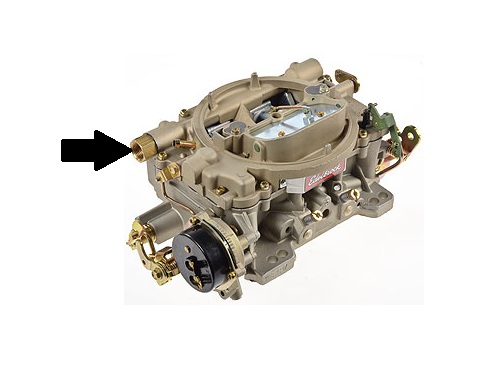

You said you didn't find a carb inlet fuel filter, so here it is, inside this inlet which is highlighted. Remove the inlet with a 1" wrench and unscrew, remove the filter and spring.
Re: Fuel filters
I have Edelbrock 1409 carbs. I removed the part that the arrow is pointing to expecting to find a filter behind it but there was nothing there.
