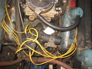

Fire order for 318 ?
So took distributor off to match up new one .. I did mark wires but ink didn't hold up well.. anyone have idea of order , if top left plug is 1 and across is 2?
wires
wires
Re: 318 fire order
For clockwise rotation engine the firing order is 18436572----- for ccw rotation engine the order is 12756348-----rotation viewed from the front of engine--- someone can jump in but I believe marine engines are viewed from the bell housing end--- anyway that will work so long as you know which way it rotates viewed from the front---Mike

Big D I am new to marine world but do understand it is marine engine . . To me where belt goes would be front or top like in car . I kept the wires in place on engine and marked the ones on distributor , 3 out of 5 ink didn't hold up well ..One way would be magnify pic and trace that way as that pic is correct for that engine
