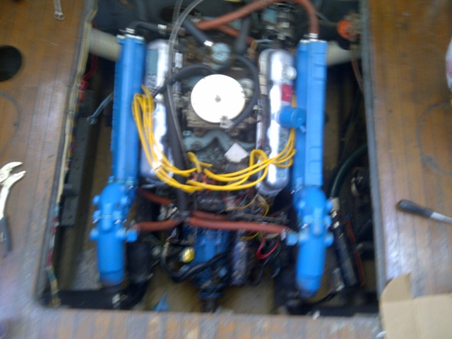

Glad you making progress . Mine is 318 but similar issues .. and finally put it together.. Over next week will put rest of it together and hopefully fire t up next weekend . Don't give up as there is light at end of tunneltoday was a good day. also the rest of the gaskets I needed came today.
dfg4240
- Getting there
- Torontoresized.jpg (114.66 KiB) Viewed 5761 times
