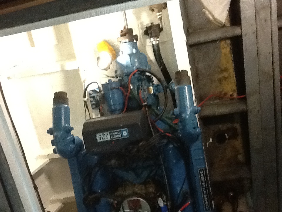

I painted the starboard side of the engine room with 2 coats of white bilge coat. It looks great. I uploaded a photo. You can see the difference where it is painted and before on the centerline. I am waiting on more Extreme Simple Green to arrive so I can clean the port side and centerline areas.

Re: What paint can I use on engine and floor of F36
Comodave -
Your bilges look great. I'm working on mine as well. BTW, you can get Simple Green Extreme from homedepot.com with FREE shipping. I ordered a case last week (4 gallons) for approx. $78 and received it today.
That is a good source for the extreme SG. I will check into it if I need more.
