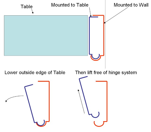

prowlersfish wrote:Lift it up
Nope. It goes down.
The 'hinge and latch' system for the table works like this : Fold the leg up out of the way, then lower the edge of the table several inches (until it's almost hitting your seat cushions). It will swing down as if it is on a hinge. Lets pretend it is now leaning down on a 20 degree angle. Then lift the back edge of the table - or the whole table - up keeping it on that same 20deg angle.
Here is a quickly scrambled together diagram of what the hinge / latch system looks like, what happens when you drop the table down, and then lift the back edge out of the hinge.
Dinette Table Latching v2.jpg (36.25 KiB) Viewed 10322 times

i love your instructional drawings!! very helpful. i'm more visual when it comes to learning, and they help a great deal.
thank you.

I guess I should have been more exact . But you do lift the end by the wall , I just fold the leg in and lift the other end very slight tilt needed on mine . Mine could be worn .

Great diagram! What tool did you use to make it?

Hate to admit it, but I am an MS Office / Powerpoint weenie, and then just used an image capture tool to grab the drawing and convert to jpg. Drew the engineering drawings for my wheel hub adapter the same way a couple of years back.
