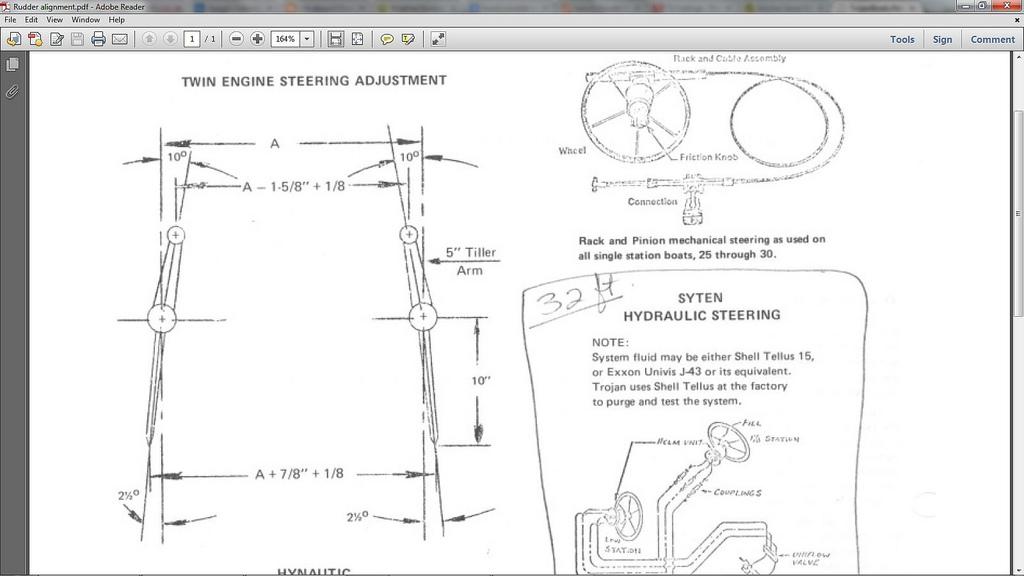

3. On plane the hydraulic steering seems to require a lot of correction and what I would perceive as slack, just like an old car with loose front end that wanders. :? Hydraulic oil low? Rudders trimmed incorrectly?

the beer is a good idea, have not cleaned bottom yet, what I see of it really does not look that bad but bet it is. Playing with trim you can steer the boat to a degree, but is not trim as it is same setting at dock not moving. Most concerned about the 3k rpm at WOT next week will check for WOT visually while underway I have a suspicion the secondaries are not opening, could be binding, though I do not think so as I rebuilt them. It could be a choke linkage adjustment that prohibits secondaries from opening until engine has enough heat in it, might be Chryslers version of the bimetallic spring in the manifold pocket that is shot.
I do not see how the boat could be heavier on one side than the other, of course I see how, but cannot locate it.
I am not familiar with hydraulic steering issues, I don't see any leaks but a low filling of hydraulic seems it would or could cause slack as could slack in the steering gear, has new steering cylinder installed, have not checked the connections to rudders yet.
I have seen a lot of info on setting rudders, seems a lot of people get boat on plane and loosen one rudder then while holding straight tighten the loose one down making them the same?
Re: questions after 2nd outing of f28 phoenix
Just measure the distance between the front of the rudders and then the back of rudders. the rear should be 7/8" farther apart (+- 1/8 ) this will give you the correct toe of approx 5 degrees total .
Ignore the tiller measurements in the photo .
This was from a post by ready123 http://www.trojanboats.net/wforum/viewt ... rudder+toe
trojan rudder ajustment.jpg (123.6 KiB) Viewed 2834 times

Thanks Paul this is a big help. The speed and rpm issues I think I can solve, my bet secondaries are not opening + dirty bottom are causing.
It seems like low hydraulic oil or air in system will cause steering slack?
It could .It sure would not hurt to check it . Do you know the type of system ? If its a pressurized system check the pressure too .
